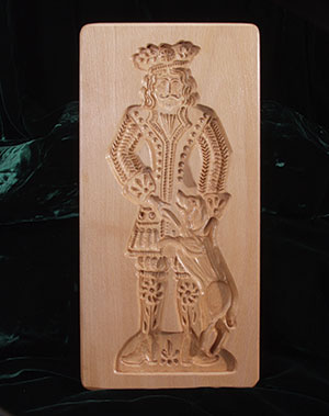

The molds vary in size from a 1 3/4″ square, four-picture “World’s Smallest Springerle Press” to a 12″ long by 5 1/2″ wide, deep-cavity mold of King William III. For Gene, carving redwood signs did not have the challenge and creativity he enjoys when carving molds.

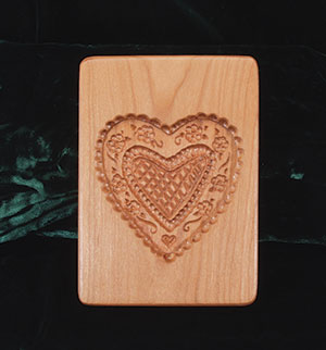

Easiest of Gene’s wooden molds to use, chilled balls of dough are imprinted as a stamp flattens them. These include animals, a rose, strawberry, holiday themes and tea party designs such as a Dutch heart, floral heart and four hearts. Gene began making his popular cookie stamps about 20 years ago from pieces of wood too small for anything else. He consigns some of them for sale to marketplaces in Illinois.

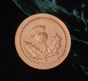

Dough pressed into the carved cavity creates cookies bearing such images as Dutch and Alpine boys and girls, a windmill, cat and large Scottish thistle shortbreads. Gene personalizes deep molds along the perimeter with names and creates cookie mold plaques commemorating such milestones as a customer’s wedding, anniversary or loved one’s birth date. He numbers some molds, such as his heavily detailed Twelve Days of Christmas.
