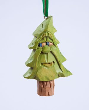

This jovial little caricature really looks great hanging on a Christmas tree. The variety of expressions you could carve for him is endless. Carve one or a forest of ornaments and create on the go by making your own personal carving desk.
Carving the Tree
Trace the pattern onto the wood and cut the outline. Taper the boughs on the front and remove any saw marks with a carving knife. Mark the bottom of the nose and the smile lines. Make stop cuts along the lines and carve up to the stop cuts to create a flat surface for the mouth. Carve the slope of the nose and the eye sockets. Then, carve the details. Use a carving knife, micro gouges, and V-tools to carve and texture the face and branches.
Make a stop cut where the trunk joins the tree, and carve back to the stop cut to separate the trunk from the tree. Round the trunk and add the bark texture with the V-tool.
Painting the Tree
Scrub the carving with a toothbrush and dish soap, rinse, and let dry. Paint the tree with thin washes of acrylic paint. When the paint is dry, apply a few light coats of clear Deft or Krylon matte finish and let it dry.
I use Floyd Rhadigan’s method of antiquing the carving. Mix equal parts of Watco natural finishing wax and Watco dark finishing wax. Apply the mixture to the entire carving with a large round brush. Blot the excess with paper towels and allow it to dry. Then, buff it with clean paper towels. Note: Dispose of the paper towels carefully; the boiled linseed oil in the wax can cause the paper to spontaneously combust. Finish the ornament by adding a screw eye on the top.
