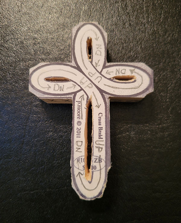

Make two copies of the pattern. Attach the copies to opposite sides of the blank using spray adhesive or glue stick. Note: To keep the cross symmetrical during the carving process, make sure both patterns are directly opposite each other on the front and back of the blank. Cut the blank to size on a band saw, coping saw, or scroll saw. Then use a scroll saw or coping saw to cut the four interior elliptical shapes. Strive to maintain symmetry during the carving since it is easy to get confused as the braids weave up, down, and over each other. Label the front and back of the blank with loop directional notations to indicate which braids will be overlapping each other.

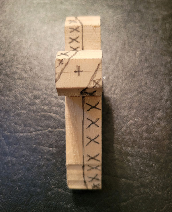

Mark the center point on the top, bottom, and both sides of the blank. Draw a centerline on each side profile around the entire blank. Note: The center lines on both sides should slope in the middle (the top part of the line should slope toward the left and the bottom of the line slope to the right) to follow the direction of braid. Draw “X”s on both side profiles to mark the wood that will be removed during the roughing out process.

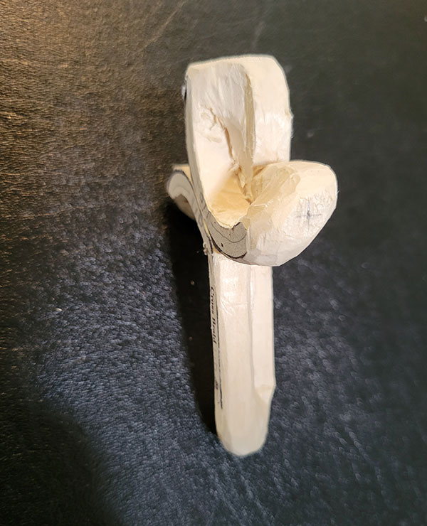

Make a stop cut around the perimeter of the top and bottom sides of the blank using a carving knife. Follow the outside lines on the cross pattern. Then make a stop cut along the side profile centerlines. Start shaping the cross by removing areas marked with “X”s on the side profile with the carving knife or gouges of your choice.  Be mindful of the grain direction as your tools could sever the braids or remove too much wood that would severely diminish the symmetrical shape and diameter of the braids. Round the inside and outside of the individual braids with the carving knife and gouges; I used a 3/16″ (5mm) micro gouge from the inside of the four loops to maintain an equal braid diameter. Then use a detail knife to separate the braids where they meet in the middle and on the side profile. Aim for the cross braids to be about 3/8″ (10mm) in width.
