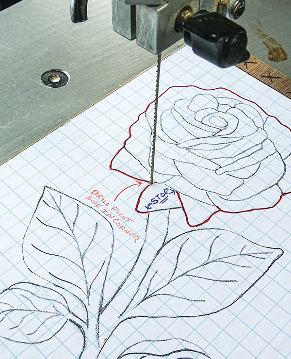

Getting StartedWhen designing any pattern, I use the following supplies: graph paper, a ruler, mechanical pencil (to keep the lines consistent), a drawing kneaded eraser (it’s easy to shape to get into tight spots), tracing paper, a light box, calipers (perfect for transferring measurements), and lots of photos of the subject. Nature is one of the best sources for ideas; barring that, search the internet for photos you can use as inspiration. Once you land on a subject, sketch it out and refine it until you are happy with the shape and level of detail. |

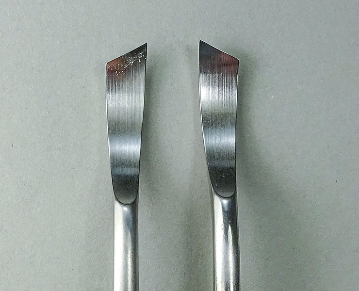

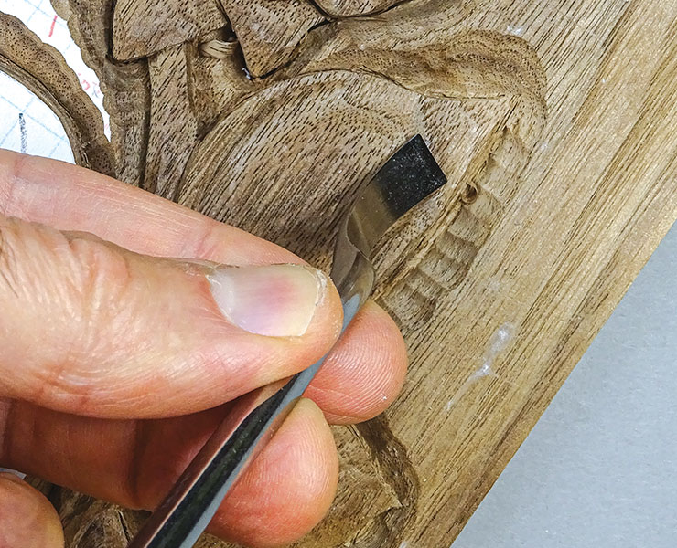

Dogleg Skew ChiselThis 90° bent skew chisel is perfect for leveling out the background of your relief carving or to reach into deep nooks and crannies. |
