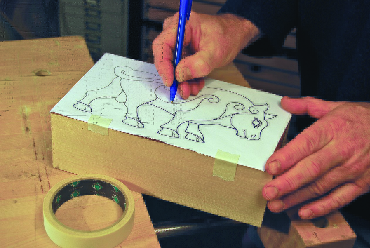

For all three versions, begin by transferring the design to your wood. I use the same pattern for all three projects, changing the color of my ballpoint pen from blue to red to black so I can see where I’ve been pressing. The ballpoint pen leaves an indentation on the surface of the wood that is readily seen when you play a light across it. You can trace along the indentations with a  pencil if it helps, but be sure to remove any uncarved marks when you are finished. As with any new technique, always practice on scrap wood first.

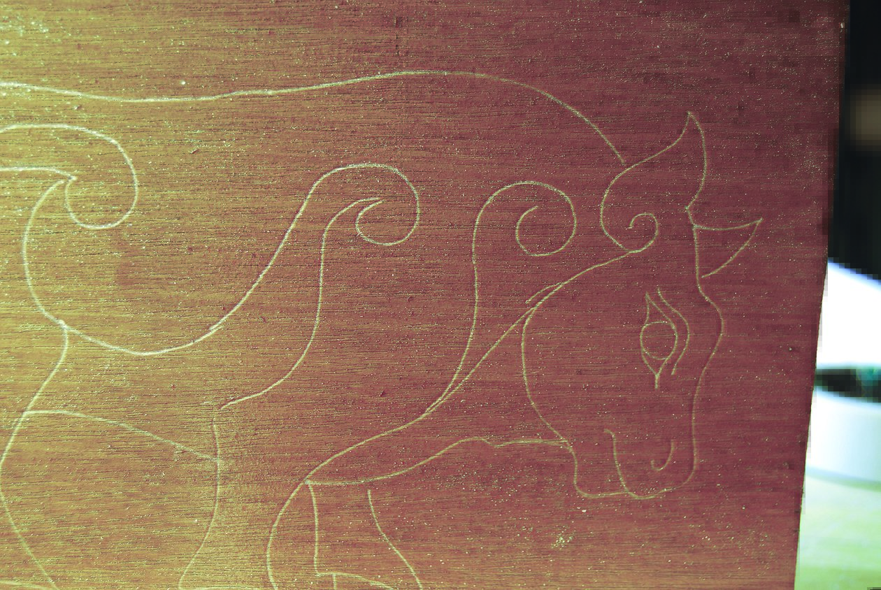

The simple line is decorative carving at its most drawing-like and must be one of the oldest styles of primitive art. To create more contrast and highlight the design, apply a dark brown varnish to the surface of the blank. Apply several coats to create a “skin” of varnish on the wood. Use varnish instead of stain, because you want the color to sit on the surface of the wood and not soak into the wood. You get one shot at carving the line, rather like an ink drawing. Use the pattern as a guide and concentrate on making a fluid line rather than tensely and slavishly following what you have drawn. You get an even width to the line by maintaining the cut at a consistent depth. While we are striving for even cuts in this design, altering the width by cutting shallower or deeper is an artistic option for other designs or future carving projects.
1. Make the long, curving cuts. Use a veiner. Make the cuts flowing, continuous, and even. Try to avoid “flats” or straight sections in what should be a curving line.
2. Cut the shavings free. Don’t pull or tear shavings away; wait until you cut them with another line or neatly nip off the ends with the tip of a skew chisel.
3. Carve the other long curves. Don’t forget to switch hands and keep the tool corners clear. As the curves get tighter, keep your elbows in and move your body around behind the tool.
4. Finish the tight curves. Use gouges of the appropriate size and sweep. Use the “high angle” grip to make crescent and slicing cuts to finish the ends of the spirals, the eye, and the hooves.
