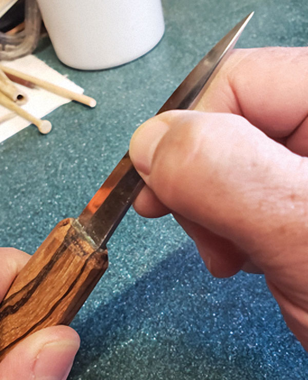

Since the Mora blade is flat, I cannot just drill a hole and glue the blade in—I need to mark the width of the blade on one of the ends of my handle (select a drill bit slightly larger than the thickness of the tang) and drill a few close holes along the line. Clean out the thin pieces of wood between the drill holes.
Apply a thin layer of epoxy to the blade tang and a little down into the hole. Slide the blade in and wipe away any excess with a rag. Let dry. Add a coat of finish to the handle and strop the blade. Check for a secure git and no wobbling before you begin to carve.

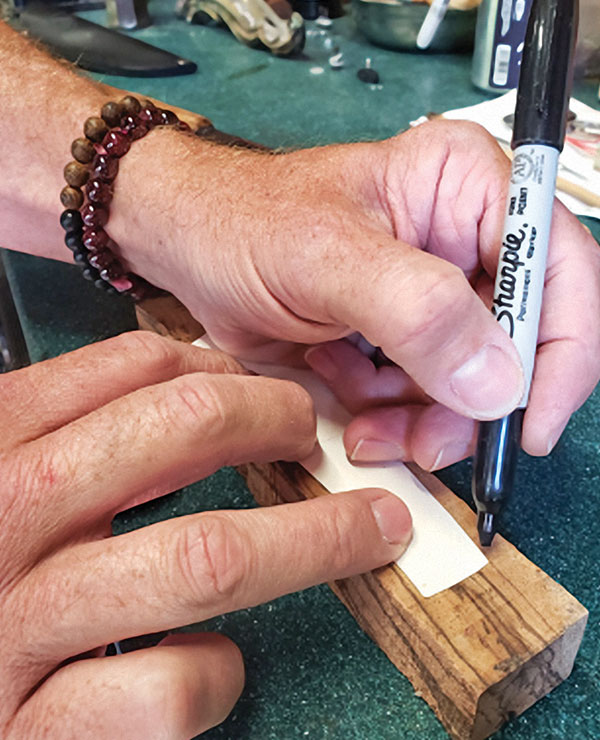

Create a template and trace the design on the wood running with the grain.
