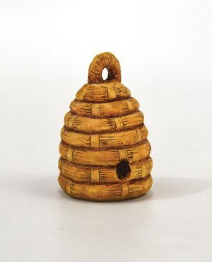

Bee Hive
3″ x 2″ x 2″ (7.6cm x 5cm x 5cm)
Bee Hive Shelf
2 3/8″ x 1 1/5″ x 1/2″ (6cm x 3cm x 1.3cm)

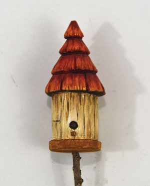

Birdhouse
4″ x 1 1/4″ x 1 1/4″ (10.2cm x 3.2cm x 3.2cm)

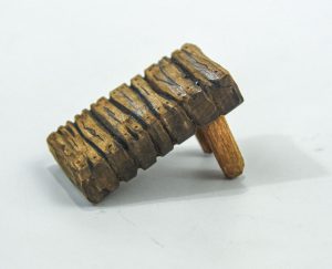

Chair
2″ x 2″ x 1/2″ (5cm x 5cm x 1.3cm)

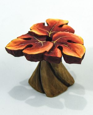

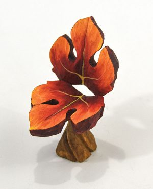

Table
top – 3 1/2″ x 3 1/2″ x 1/2″ (8.9cm x 8.9cm x 1.3cm);
base – 1 3/4″ x 1 3/4″ x 1 3/4″ (4.5cm x 4.5cm x 4.5cm)

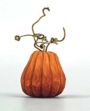

Pumpkin
1 1/2″ x 1 1/4″ x 1 1/4″ (3.8cm x 3.2cm x 3.2cm)

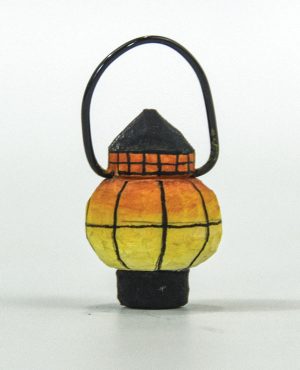

Lantern
1″ x 1″ x 1 1/4″ (2.5cm x 2.5cm x 3.2cm)

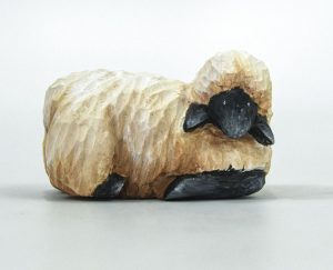

Sheep
2 1/2″ x 1 3/4″ x 1 3/4″ (6.4cm x 4.5cm x 4.5cm)

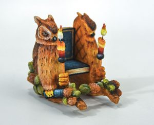

Owl Chair
books for seat – 1 1/2″ x 1 1/4″ x 3/8″ (3.8cm x 3.2cm x 1cm);
candles – 2″ x 3/8″ x 3/8″ (5cm x 1cm x 1cm);
owls – 4 1/4″ x 3 1/2″ x 5/8″ ( 10.8cm x 8.9cm x 1.6cm);
foot rest – 2″ x 1/2″ x 1/2″ (5cm x 1.3cm x 1.3cm)
