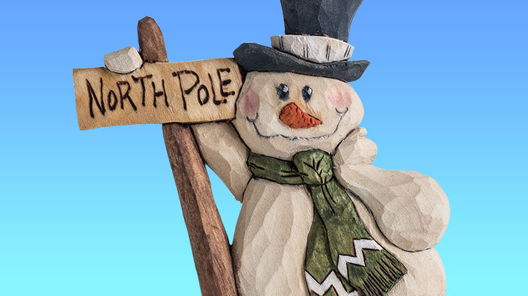

While on a trip to Las Vegas, I came across a picture of a snowman on the side of a building. I thought it would make a great Christmas ornament! I made a few changes to the design to make it my own, and created this piece.
Making the Ornament
Transfer the pattern to the blank, and then carve the design with your choice of tools. Outline the details with a woodburner and skew or writing nib. Wash the carving with a spray cleaner, such as Simple Green®, and scrub it with a denture brush. Rinse well, and apply painting while the carving is still wet. Mix equal parts paint and water to create thin washes. Once dry, attach a small jewelry finding or eyelet to the top of the ornament with cyanoacrylate (CA) glue. Display as desired.
