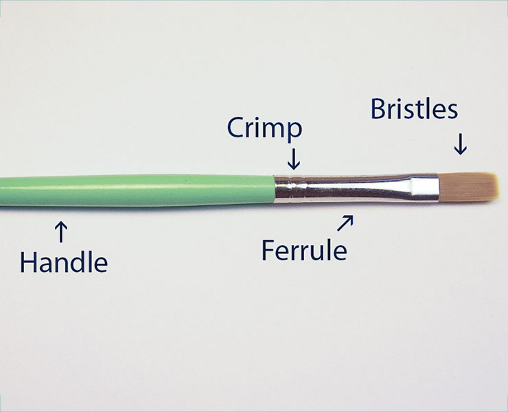

Bristles
Naturally, the bristles are the most important part of the brush. They are made either with synthetic fibers (these are very “springy” and smooth in texture), natural fibers (hair of various animals—kolinsky sable, pony, hog, etc.) or a combination of the two fibers.

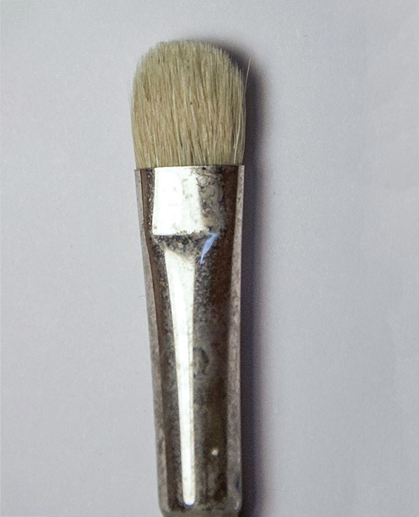

Natural bristles have barbs or scales, which make them thicker, stiffer, and a little harder to clean. Due to their stiffness, natural bristle brushes are mainly used for canvas painting with thicker paint. Typically, they are more expensive than synthetic brushes; however, some can be less expensive than the synthetic options.

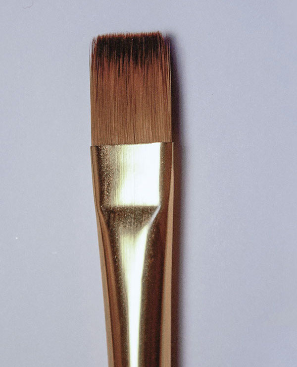

Synthetic brushes, which are smoother and springier than their natural counterparts, go with a variety of paints and are typically easier to clean. I use mainly synthetic brushes for applying paint, but I reserve some natural bristle brushes for blending. Pricing depends on the size; I spend $3-$5 on smaller brushes and $10-$15 on larger ones. However, buying a set is usually cheaper.

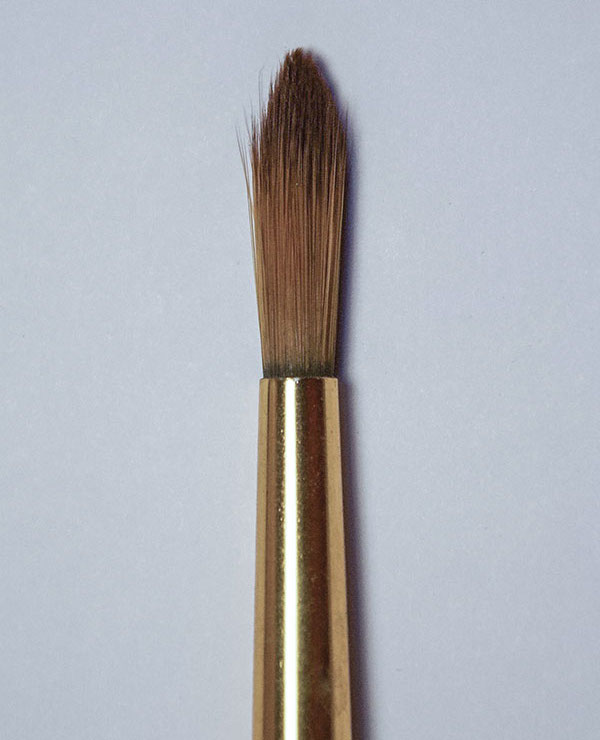

Rounds
Workhorse of the set; used for applying paint and washes.

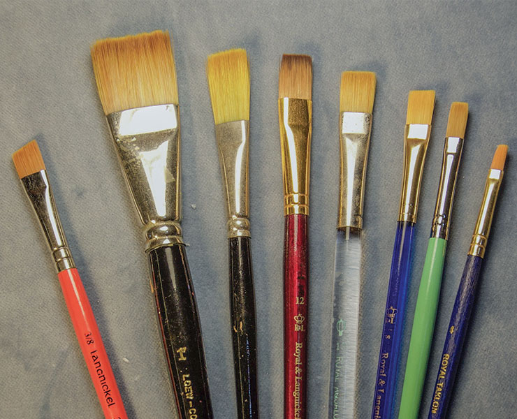

Flats
Used for painting large areas and adding textures, such as house or roof details.

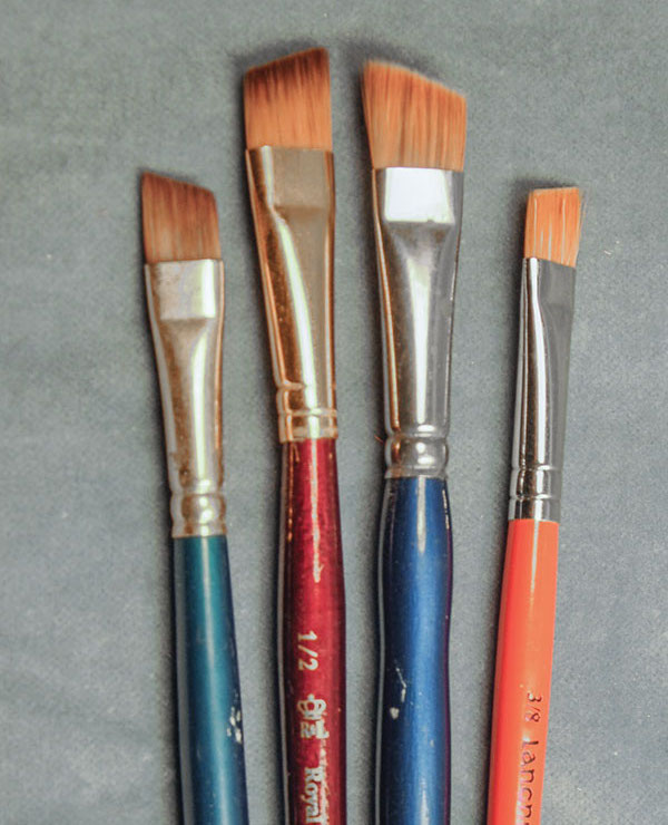

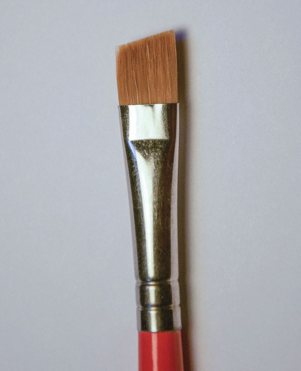

Angled flats
Used like regular flats, but tip can reach into smaller areas.

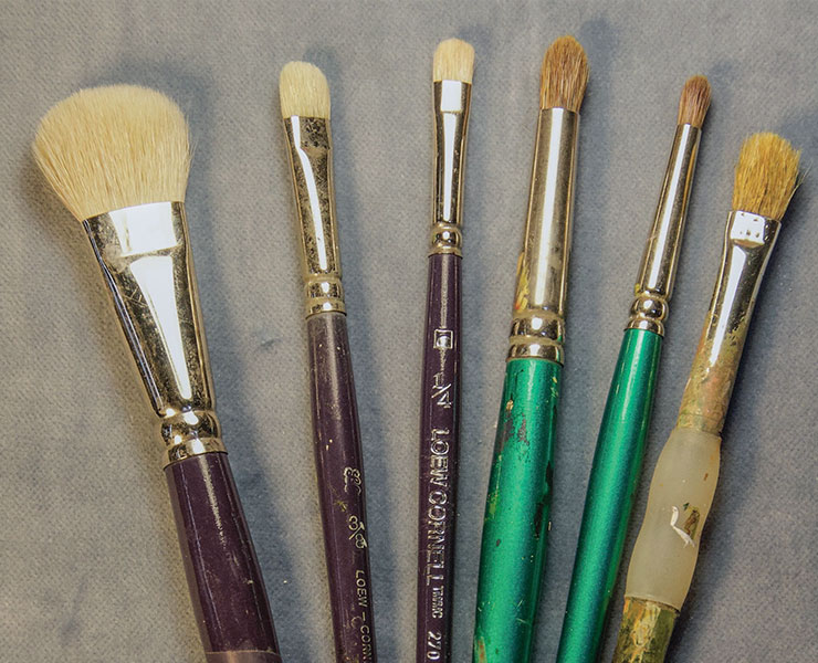

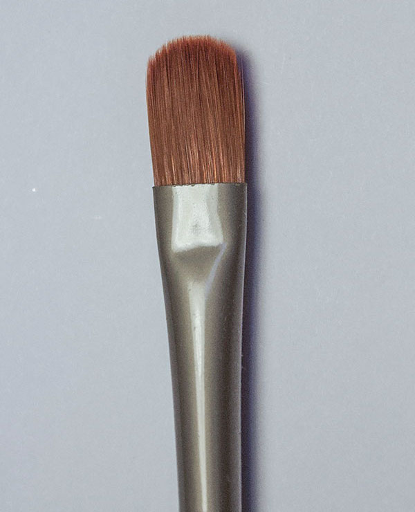

Filberts
Good for blending or painting a soft edge.

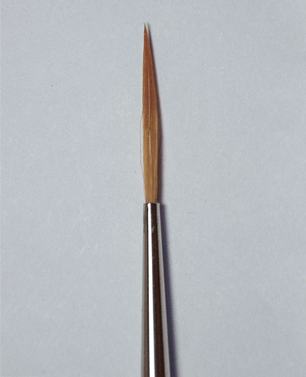

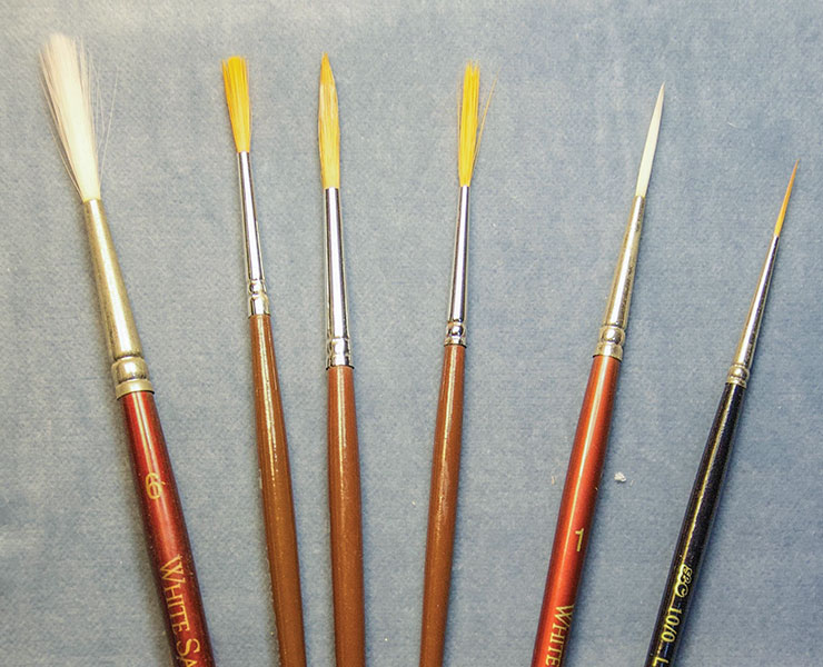

Script liners
Used for fine lines and detail
Blenders
Used to blur the border between two colors to form a gradation of color.

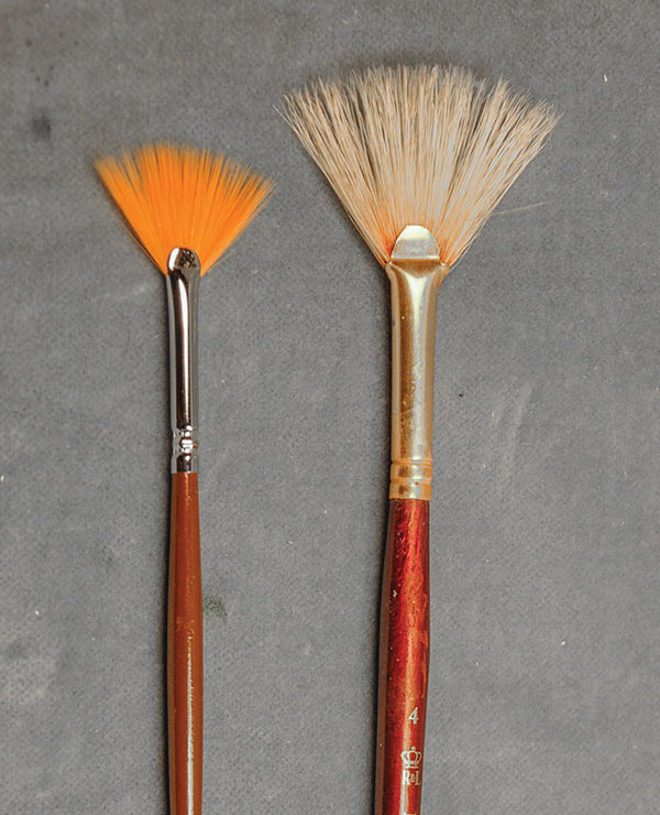

Fan brushes
Used to paint textured areas like clouds, trees, or leaves.

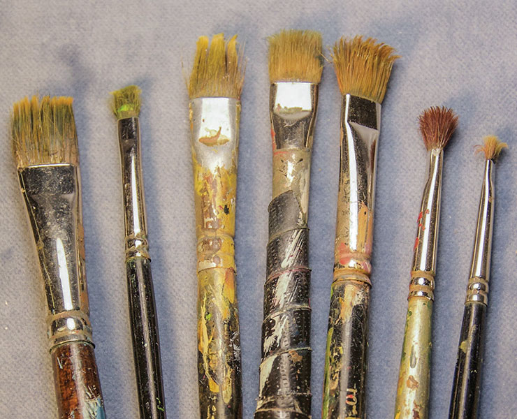

“Spoiled” brushes
Great for blending and adding texture (It may be the Yankee in me, but I have a hard time throwing a brush out!).

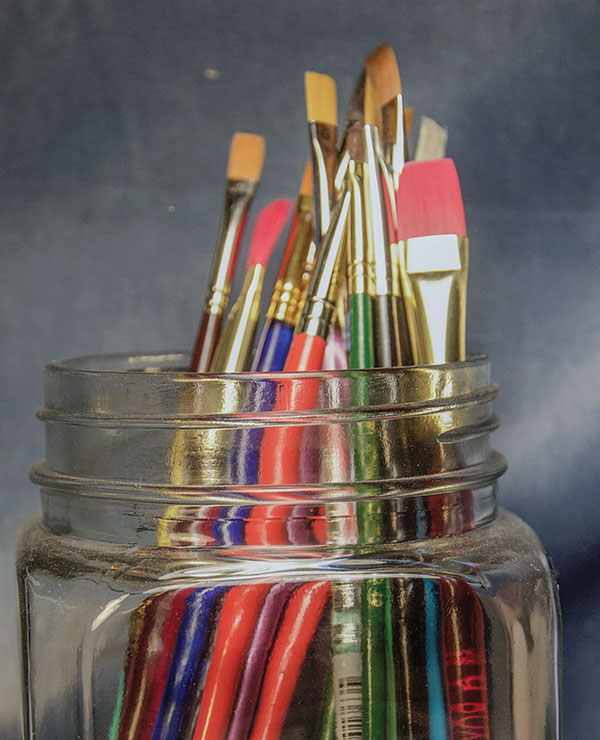

Storing Your Brushes
Store your brushes upright in a container so the bristles don’t bend. I use a simple jar for organized storage and easy access. You can get carriers of all sizes at any art supply store if you need to transport your brushes and other painting supplies.
