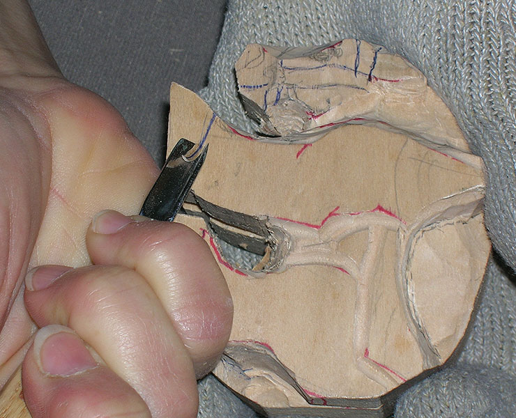

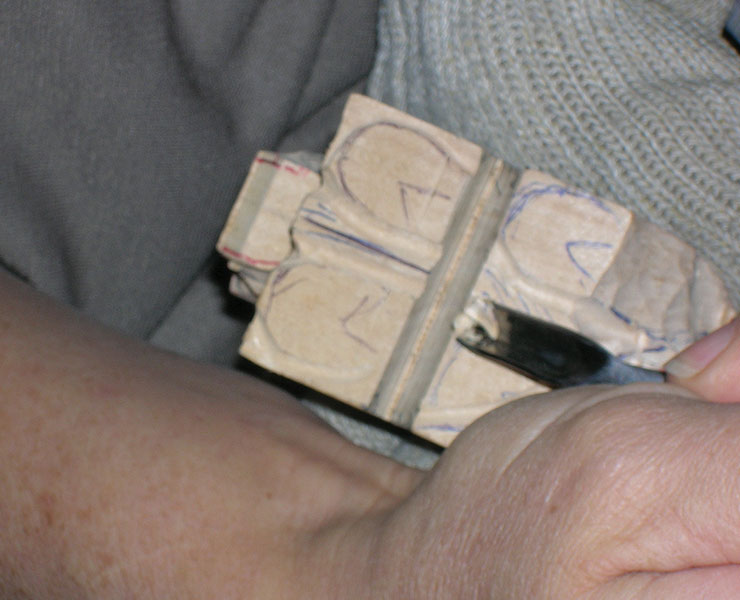

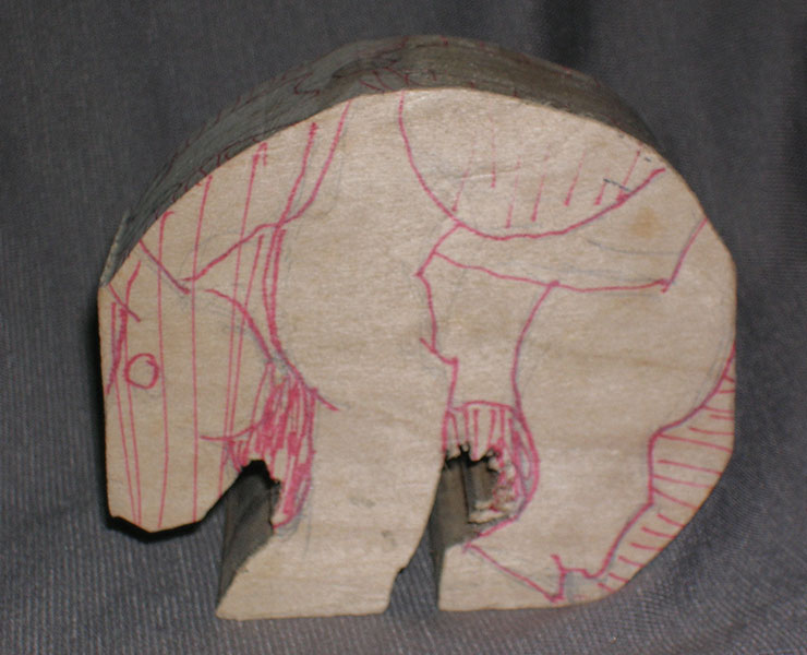

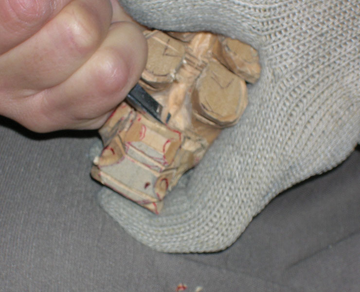

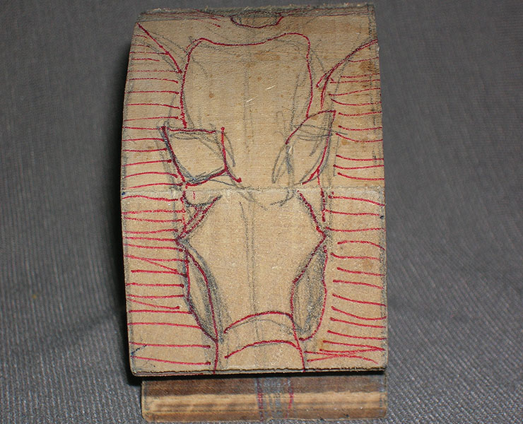

1. Cut out the side view. Transfer the side-view pattern to the blank. Then cut the side view with a bandsaw or coping saw. Transfer the top and bottom view patterns to the blank. Mark the areas to be removed.

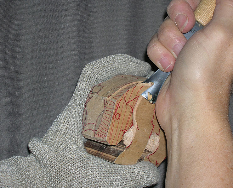

2. Begin rough-shaping the piece. Remove the marked areas with a 13mm #5 fishtail gouge. Then draw in the saddle details, and mark the parts to be removed. Work on both sides for a symmetrical result.
3. Outline the details. Draw in any detail lines that have been carved off using the pattern for reference. Follow the sketched lines to outline the details with a 10mm 45º V-tool.

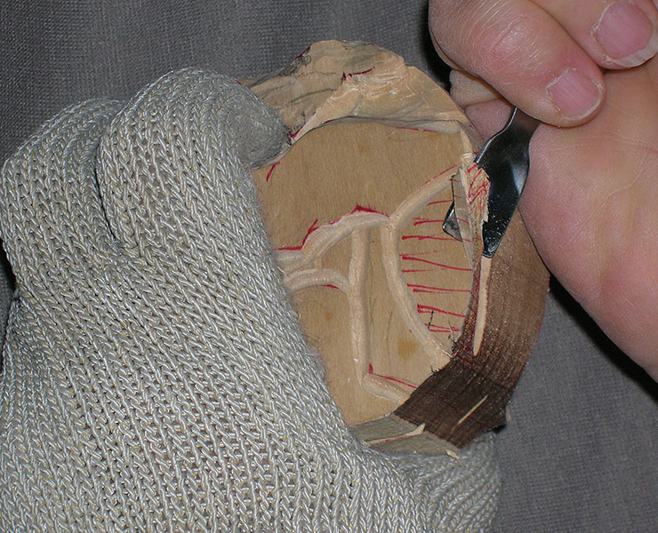

4. Continue shaping the horse. Relieve the saddle and neck areas up to the V-cuts. Use a fishtail gouge to continue roughing out the horse. Redraw your reference lines as often as necessary.

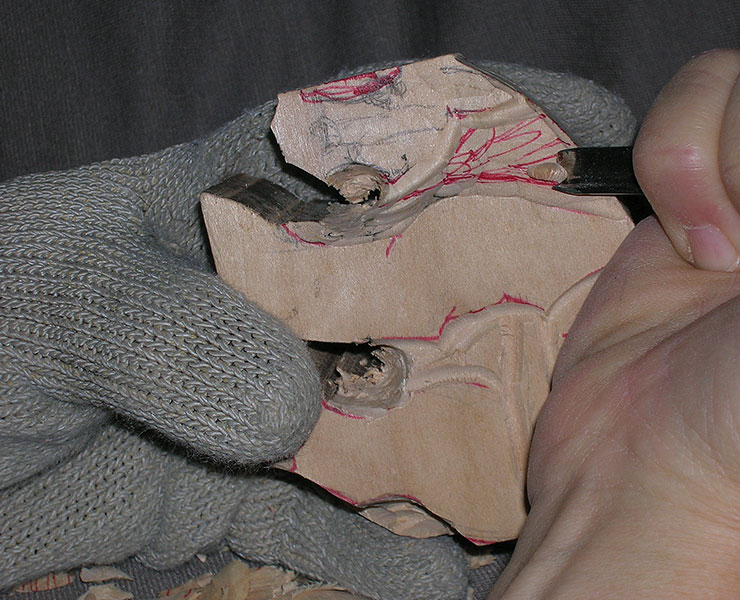

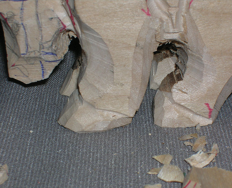

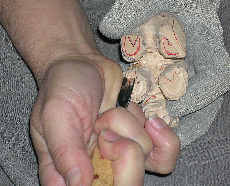

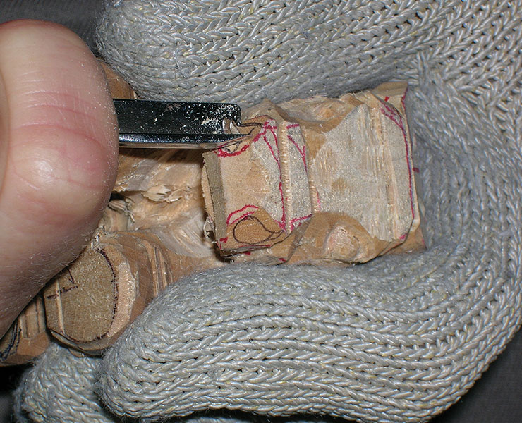

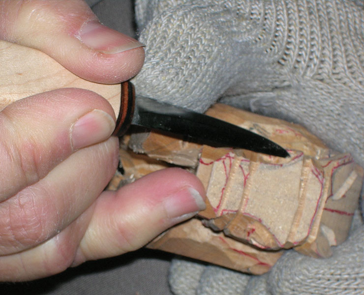

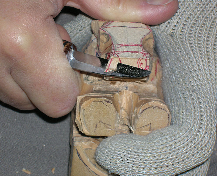

5. Separate the legs. Sketch on the bottom hoof details. Use a 6mm #11 veiner to separate the legs.
6. Shape the legs. Mark the hoof details. Use a V-tool to cut along your lines. Then round the legs with a detail knife.
7. Shape the hooves. Use a detail knife to round each hoof and taper them to the legs.

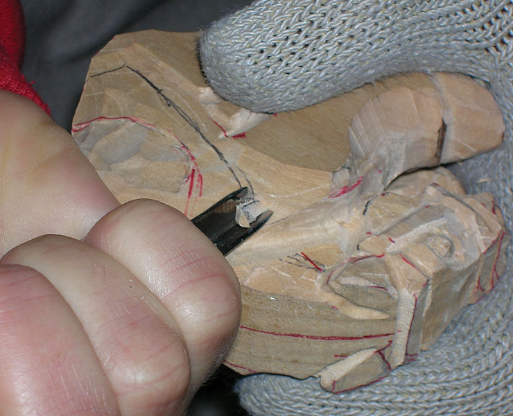

8. Rough out the face. Mark the bridle details. Cut off the corners of the nostrils with a detail knife and cut along the bridle lines with a V-tool.

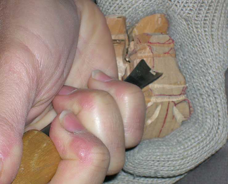

9. Shape the saddle area. Cut up to the saddle, using a 22mm #5 gouge. Round and shape the area evenly on both sides.
10. Draw in the eyes and mouth. Make a V-cut along the top portion of the eyeball and along the mouth line.
11. Shape the eye. Make a stop cut along the bottom part of the eye with a detail knife. Then round the eye with a detail knife.

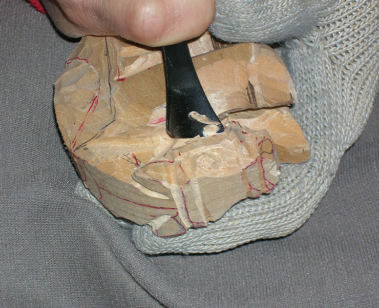

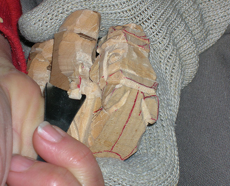

12. Undercut the facial details. Use a13mm #5 fishtail gouge to undercut the eyeball in the eye socket and the bridle.
13. Shape the nose. Draw on the nose details. Undercut the bridle with a fishtail gouge and carve in the nostrils with a V-tool.

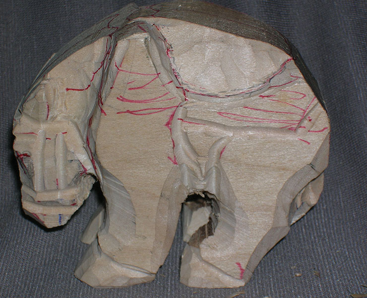

14. Add the blanket details. Draw the blanket on. Then define those lines with a V-tool.

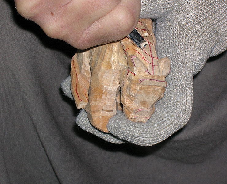

15. Round and shape the shoulders. Use a 22mm #5 gouge and work on both sides to achieve a symmetrical appearance
16. Add texture to the mane and tail. Draw the texture details in. Then use a V-tool to add the texture.
17. Detail the bottom of the hooves. Draw in the details and  cut them with a V-tool. Examine the horse from different angles and touch up any necessary areas.

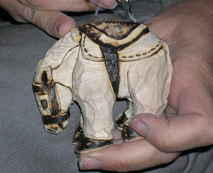

18. Burn in the final details. Use a fine woodburning tip to burn in the eye and outline the bridle.
