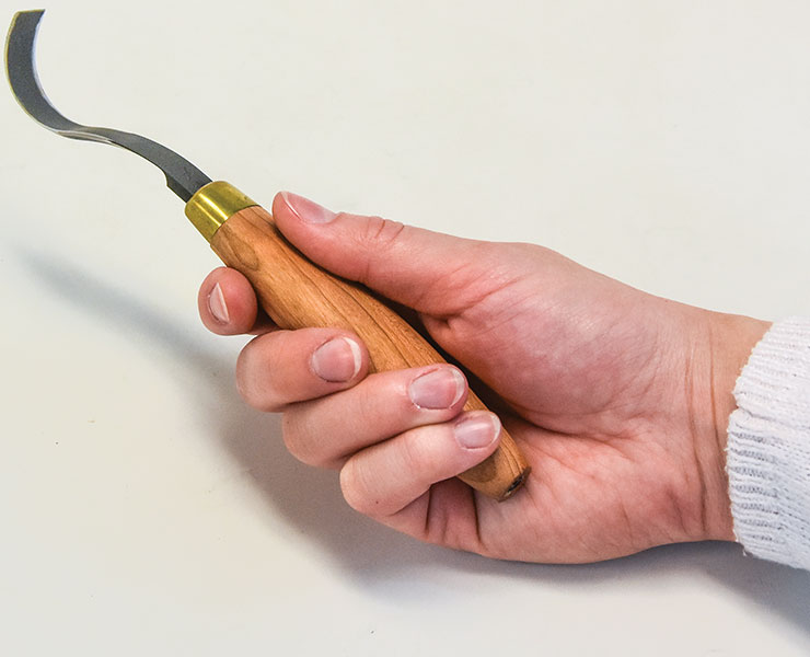

When you grip the handle, the tips of your middle and ring finger should lie about 1/4″ (6mm) away from or just against your thumb palm. This lets you have free motion of your fingers, thumb, and wrist during any cut—not too tight and not too open. Your fingers should hold the knife handle to the palm without the need for excess pressure.
If the handle is too narrow or thin, your fingertips will need to curve into a clenched shape to hold the knife steady. That causes extra tension in the hand, which over time becomes tiring.
If the handle is too wide, your fingertips will not touch the thumb palm area. To hold it securely, you would need to grip tightly to steady the knife through the cuts. This, too, can cause fatigue and stress on your hands.

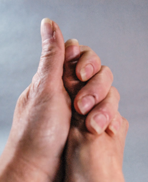

To gauge how well a knife handle will fit your hand, wrap the fingers of your dominant hand around your other thumb. Your thumb represents the knife handle, which rests across your palm. Since the fattest part of your thumb sits nicely in this area, you can use it to see how thick a knife handle you can comfortably use. This is why I never recommend ergonomic grip tool handles, because they only perfectly fit one person’s hand—the person (usually a man) who made the handle mold in the first place.

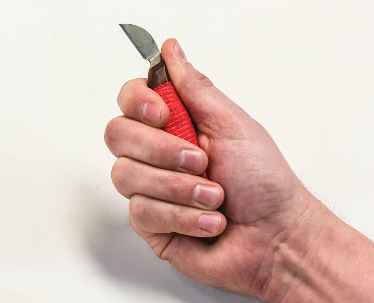

TIP: Adjusting A Handle
If your knife handle is too large, sand or carve it down to fit your hand. If the handle is too small, wrap vet-wrap tape around the handle to build it up.

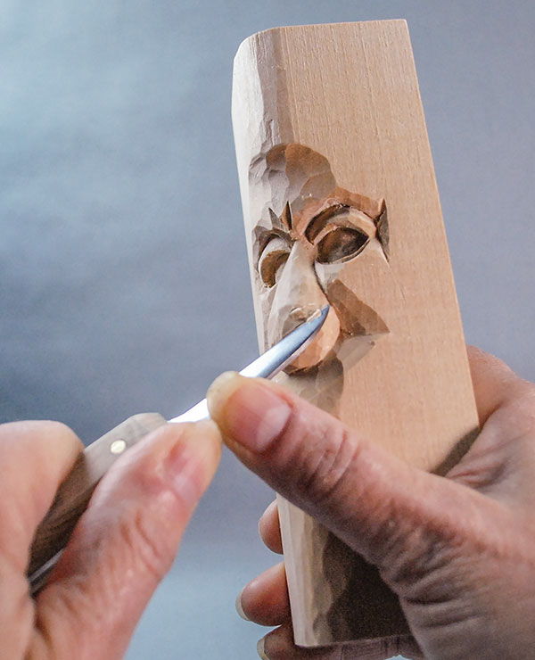

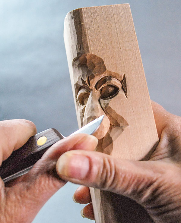

And for most carving projects, especially if you’re working with milled and kiln-dried wood where the bark and heartwood have been removed, it only needs to make a clean 1/2″ (1.3cm)-wide slice. A longer knife puts your hands farther from the details you’re carving and reduces your control (above right). If you do need to take larger slices, clamp the wood and use a drawknife; this allows you to use both hands on the tool, keeping control despite the length of the blade.
A shorter blade length (top) will afford you more control.
