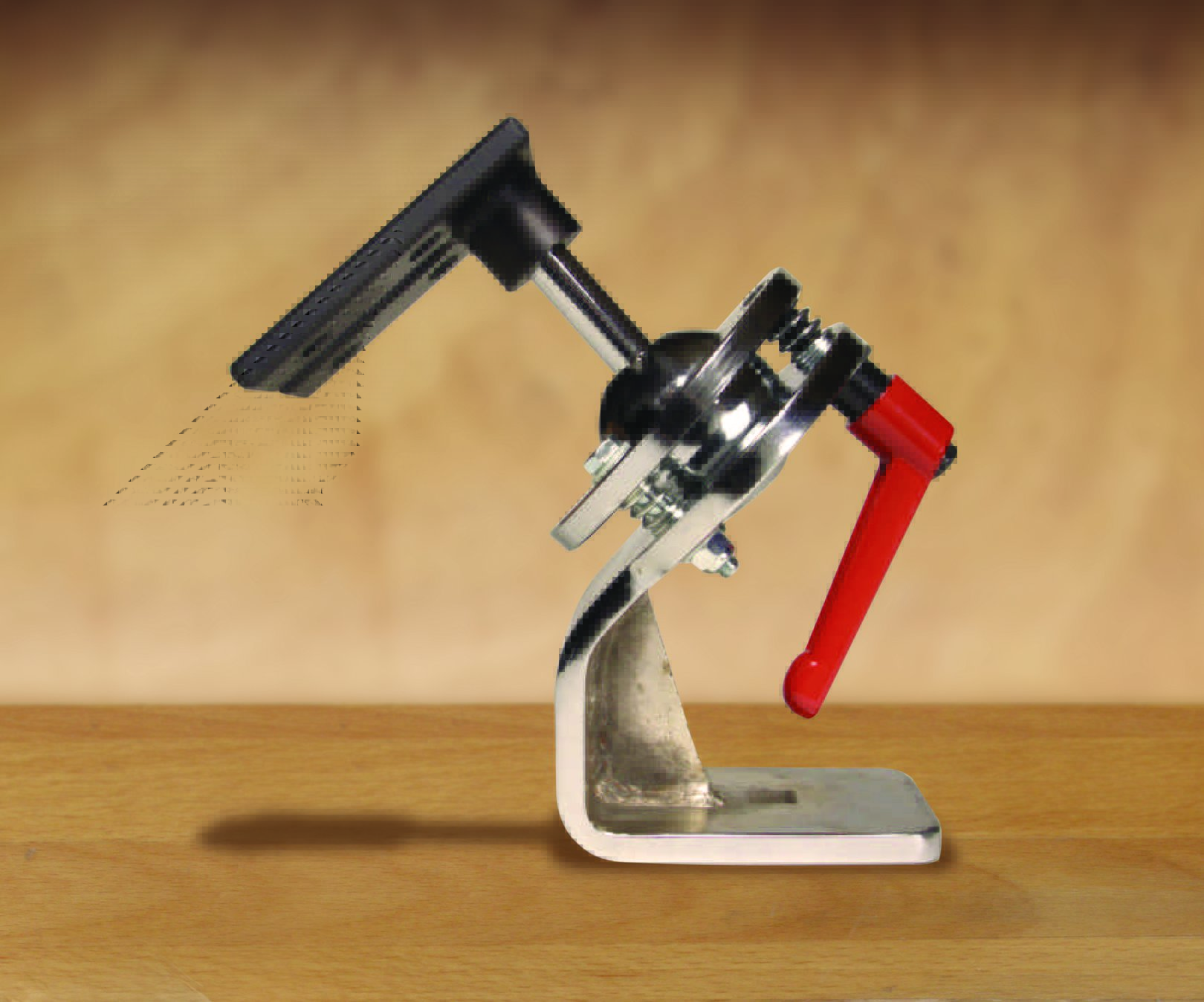

Holding Devices
Traditional woodcarving involves long carving tools, and carvers hold these in both hands, often ambidextrously. There are certain exceptions—such as when you are using a mallet, or when “backing off,” a technique where one hand supports a fragile element of wood and just offers a thumb to aid the other hand as it manipulates the tool—but in general, both hands of the carver hold the carving tools. Therefore, we need something to hold the wood: a holding device.
Again, that wide range of carving types and sizes means there will be many ways of holding work, some suitable to one project, others suitable to another. Holding devices can range from cheap, simple bits of waste wood to expensive adjustable clamps. Whatever you choose, the more adaptable the better. Many beginners think they cannot achieve good work without a special and expensive way of holding work. Some modern devices do have many advantages, but remember just how ancient this craft is and how carvers must have worked in the past. You really don’t need much!

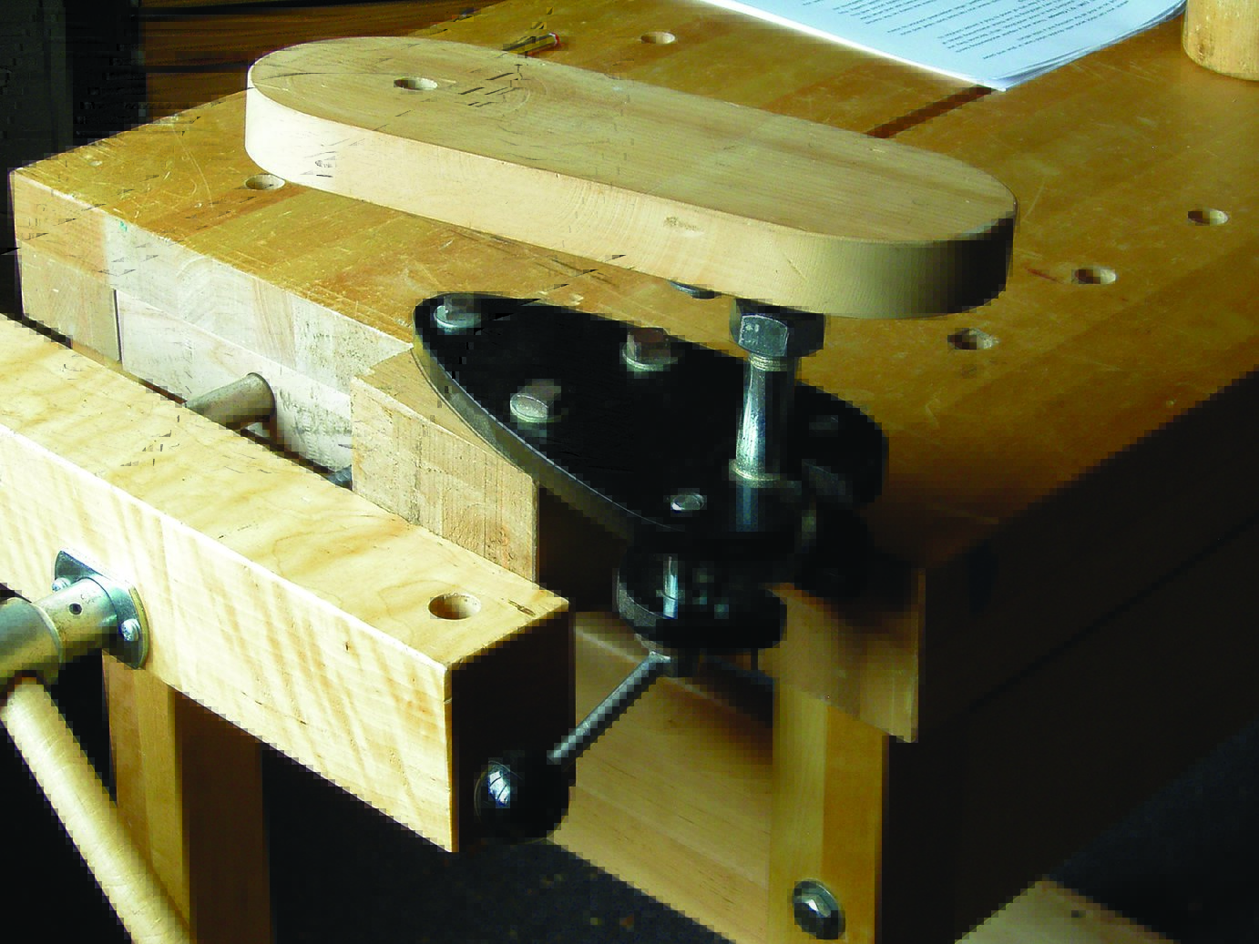

Pye-Shim Vise 8 9 10 Jerry-Rig Ball Mount 12

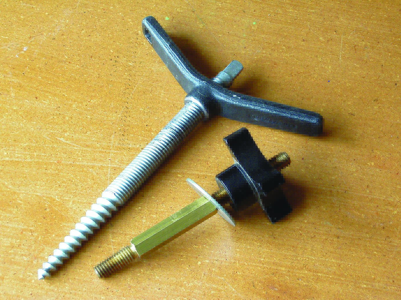

Woodcarver’s screws: the larger one by Stubai and the smaller by Veritas.

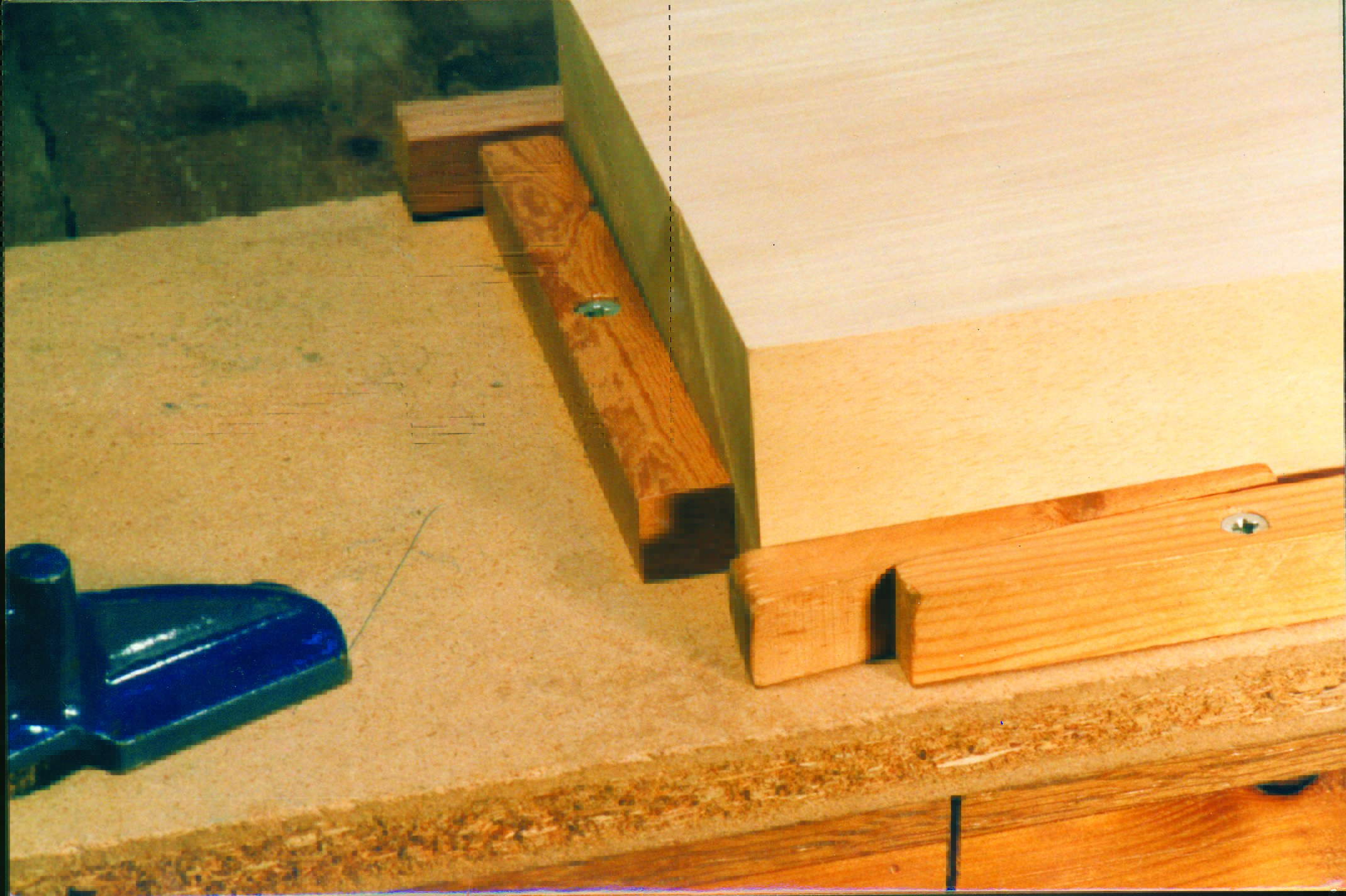

Whatever you use, some principles are invariable in the way you hold your wood to carve it. Your device should:
Hold the work securely: Only the tools move, not the carving. A sudden tilt or shift of the work at a delicate stage can be nothing short of disaster.
Allow you to get at the area you wish to carve: This usually means some way of reasonably quick adjustments. The need for back-breaking yoga-like postures, while interesting to spectators, doesn’t contribute to successful carving and is a sign you should re-think the way you are holding your work.
Be safe: Not injure yourself or your work.
As we go along in the series and work on different projects, I’ll briefly introduce you to a variety of ways of holding your work. For now, let me just mention my “A team:”

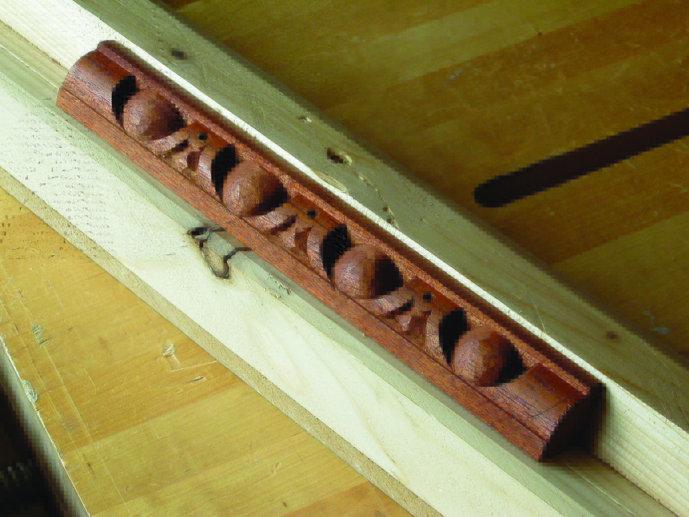

  • Bits of wood: Yes!—it’s amazing what you can achieve with fences and wedges, posts clamped in carpenters’ vises, boards onto which you can stick work with double-sided tape or glue and paper and so on. And all for nothing but a little effort!

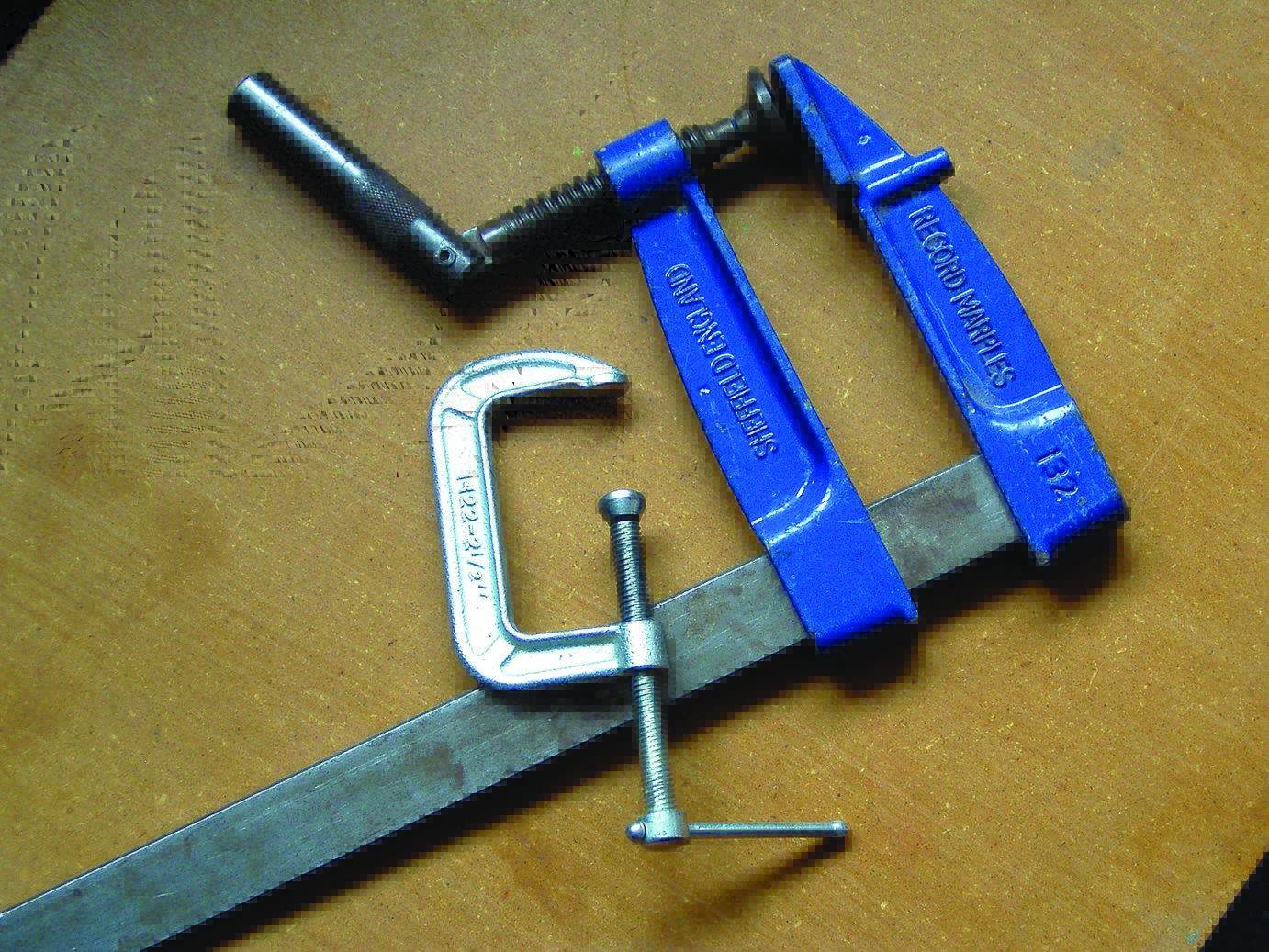

  • ‘C’ Clamps: These and a regular woodworking bench vise are standard fare in most workshops. Why? Because they are so useful! It’s very satisfying to use these unassuming pieces of equipment and a few bits of wood to find a simple solution to holding your carving.
  • Carvers Screws: With these you can hold both relief and “in-the-round” work. A simple, elegant, often underrated solution to many holding problems.
  • Adjustable clamps and vises: There are many on the market and it’s a good idea to see what other carvers use and what their opinion is. View these devices as a starting point. You can attach pieces of wood to the metal plates to suit the particular carving you are working on. This adaptability is a key element in successfully holding and working with your woodcarvings. Some are expensive, some reasonably priced and this doesn’t seem to have a whole lot to do with the build quality. You just need one: see it as a starting point and create platforms, etc. using wood.
I’d suggest you wait to buy anything until later in the series when you see what these devices can do and whether they fit the sort of carving work you have in mind. Bear in mind that if you are only carving one sort of thing in the future, you will only need one (successful) way of holding it.
