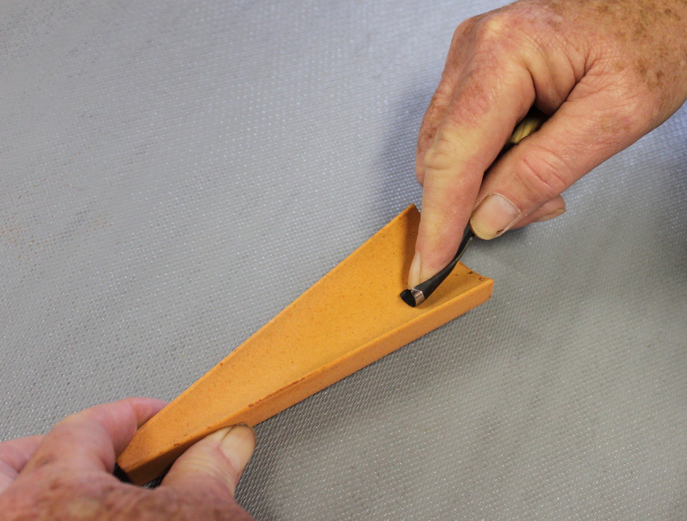

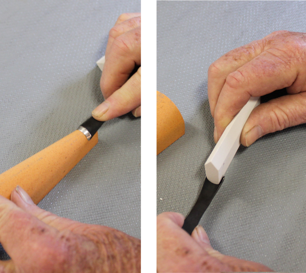

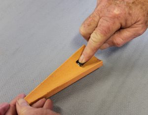

It is possible to sharpen gouges with a flat stone, but I prefer to use a conical slip stone or gouge stone. Regardless of the stone you use, the goal is the same: to produce a wire edge on the inside of the bevel. The bevel is the part of gouge that does the cutting and it is what we sharpen and keep sharp. A wire edge is a continuous burr that forms when the edge of the tool gets thinner as you sharpen.

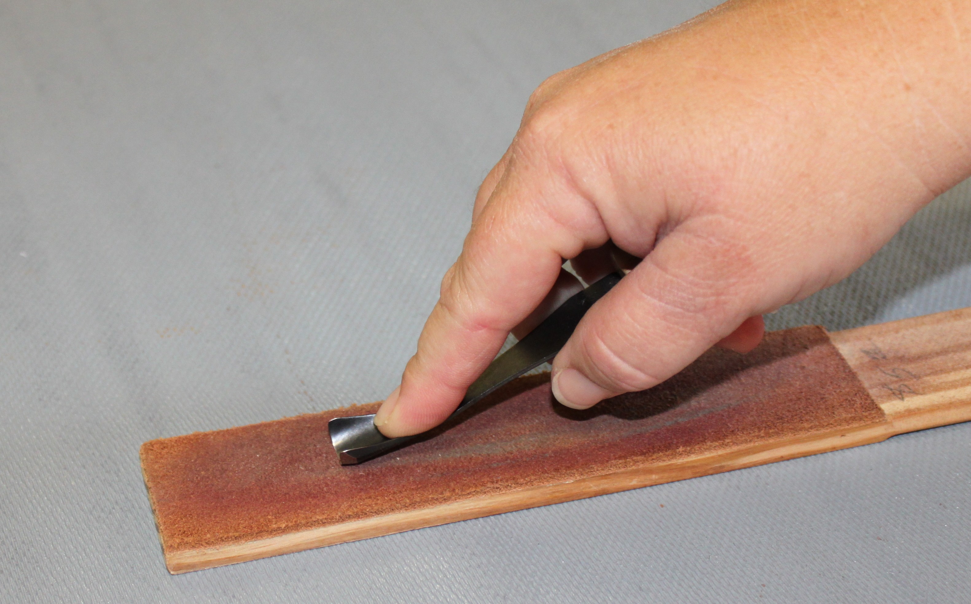

Once a gouge is sharp, you should never re-sharpen it unless you break it, chip the edge, or have to re-shape the bevel. Just strop the gouge when needed to maintain a sharp cutting edge.
