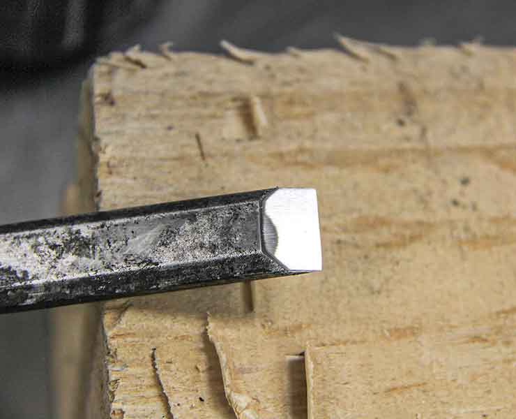

The entire stropping brings up a mirror-like finish and only takes a few minutes to achieve, as opposed to the much longer and more tedious hand-stropping method.
Dave achieves  a mirror finish on his tools with minimal time and effort.
