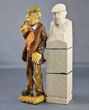

The rule of three is an easy way to envision a human figure in a block of wood before and during the carving process. All human figures have the same basic elements. These elements need to be in proportion to avoid creating a carving that looks distorted. The rule of three is a simple guideline to keep human figure carving in proper perspective and proportion. After learning about the rule of three, try the technique out on the hobo caricature below or a magical wizard from issue #64.

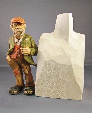

I carve my figures out of a block of wood with square corners. This raw carving medium gives me more freedom and allows me to be creative, rather than being limited by a predetermined pattern or outline of the sawn-out blank or rough out. This freedom allows me to come up with a unique design. Carving from a patterned sawn-out blank or a rough out limits creativity. While exercising your creative freedom, it’s important to maintain proper proportions in your figure. While you are engaged in cutting down the block of wood to the basic shape and form of the subject, it is helpful to have guidelines for the basic proportions. Proportional guidelines, such as the rule of three, will help you create a well-balanced and proportioned figure carving.

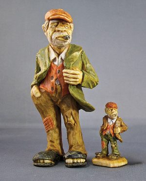

The rule of three works for carvings of all sizes, from miniatures to life-size figures. It is easier to remember and apply the rule of three than the traditional guideline of a figure being eight head-lengths tall. By keeping the rule of three in mind, you can design any human figure and adapt it according to the clothing, age, race, and occupation of the figure. The rule of three works for any figure, from clowns and hobos, to Indians, pirates, and Santas.

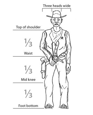

• Divide the body, below the head, into three equal sections: the shoulders to the waist, the waist to mid-knee, and mid-knee to the bottom of the feet.
• Use the width of the head to determine the correct width of the body. At the shoulders, the body is three heads wide.

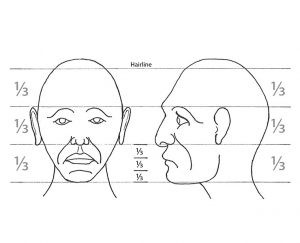

• Divide the head into three equal sections: the hairline to the eyebrows, the eyebrows to the bottom of the nose, and the bottom of the nose to the bottom of the chin.
• Position the ears in the center section. The ears sit on the back half of head and are the same length as the center section—from the eyebrows to the bottom of the nose.
• The bottom section, between the nose and the chin is further divided into three equal sections: the nose to the upper lip, the upper lip to the indention between the bottom lip and the chin, and the indention to the bottom of the chin.

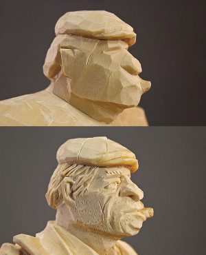

Use the rule of three to block out the elements on the figure’s head. Note the head fits up into the cap; the cap does not sit on top of the head. Envision the top of the head inside the cap to produce the proper proportions.
Add details to the carving only after you have blocked out all of the elements. Continue using the rule of three to ensure the figure maintains good proportions.
