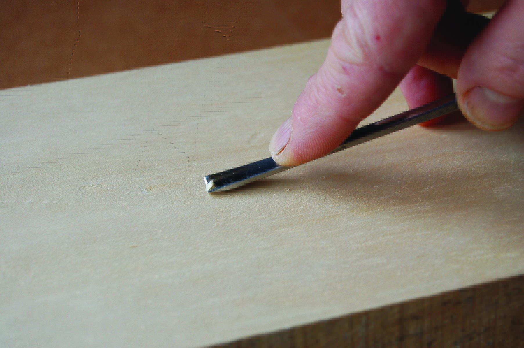

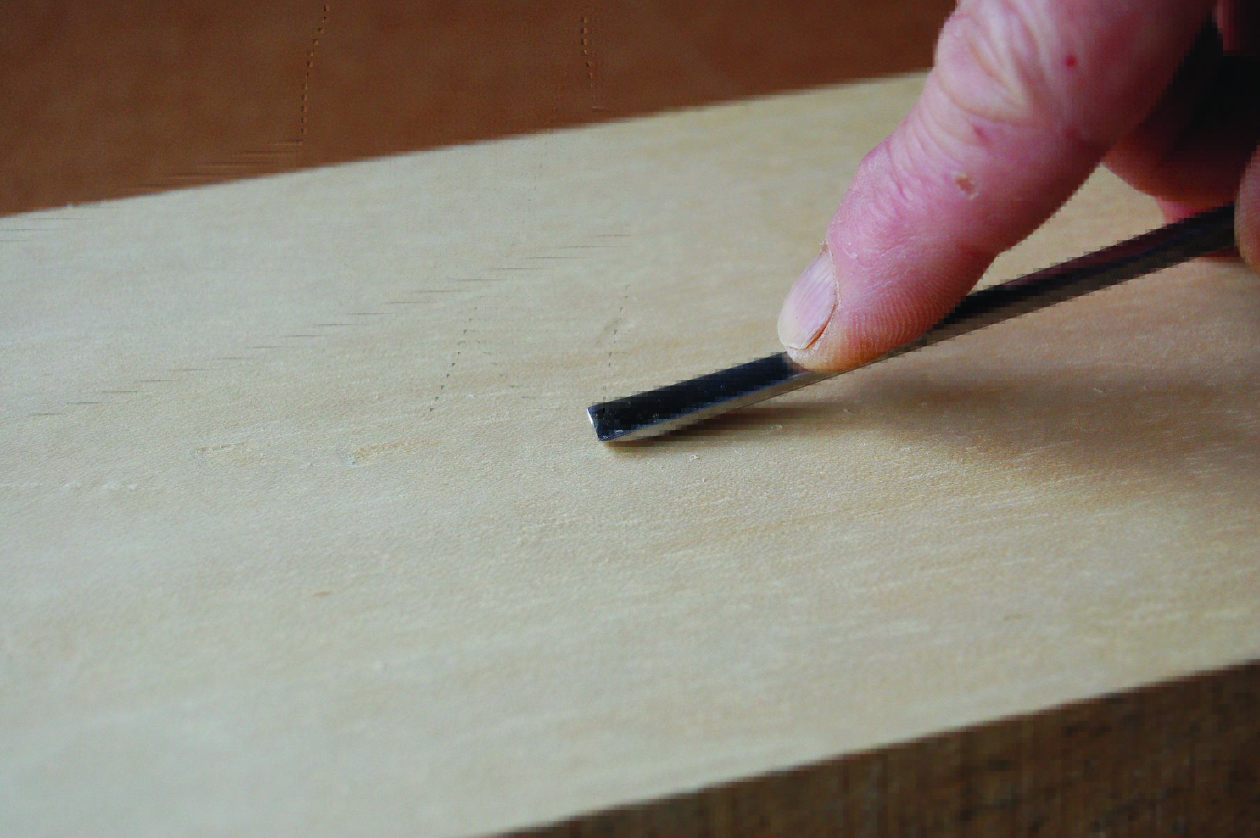

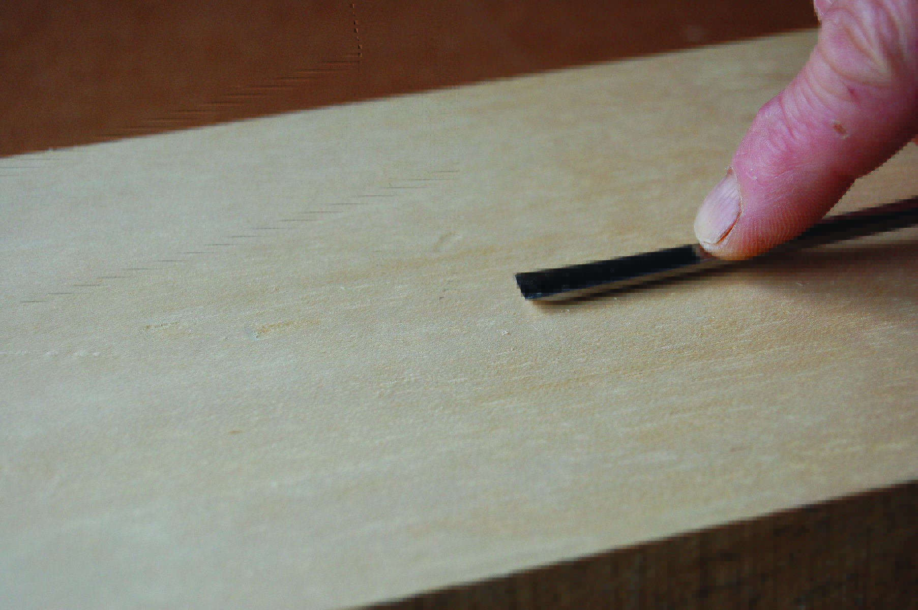

Let me give you this demonstration first:
Place your gouge hollow upwards on a clean flat piece of wood.
Slowly move the gouge forward while raising the handle.
When the cutting edge nicks the wood, this is the cutting angle, the angle at which it cuts.
So, with an inside bevel: You can far more easily cut with the gouge upside down. Without the bevel, the cutting edge tends to jig and bury itself into the wood, rather than rising out by pivoting on the heel of the inner bevel. The inside bevel strengthens the edge by increasing the overall bevel angle. This allows a lower cutting angle since the outer bevel can be longer. An inner bevel eases the shaving up and out of the deep channel between the metal walls. Thus there is a very special configuration in a carving gouge.
