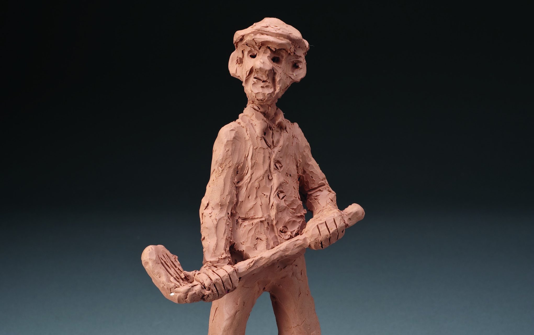

Use dividers to transfer measurements from clay models, patterns, or study sticks to your carving.

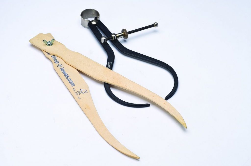

Simple Shopmade Calipers
Carver, author, and instructor Rick Jensen creates his own calipers from the wooden paint stirring sticks hardware stores give away when you buy paint. Rick shapes the lower part of each stick into a graceful curve that ends in a point. He drills a hole in the other end, threads a machine screw through the hole, and locks the screw in place with a wing nut. While a caliper like this probably isn’t accurate to the thousands of an inch, it is more than accurate enough for a carving.
