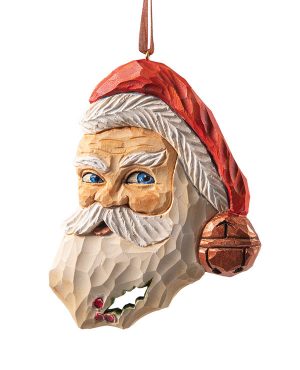

This jolly fella is a relief carving with vanishing point perspective. The vanishing point of his face is far to the left when you face him, which creates the illusion that he is looking away. Note: It might be helpful to look in a mirror, turn your head left, and look back into the mirror with just your eyes. Notice how your features look, and how they differ on opposite sides of your face.
   For this project, whenever you use a veiner or gouge anywhere on the face, the size used on the right side will be larger than the tool used on the left side. I added holly in Santa’s beard for some extra fun.

Use a knife to cut back and round the right side of the face. You will have to redraw the right eye, cheek, and mustache. Block out the hat, fur trim, and bell with a 3/8″ (10mm) 60° V-tool. Set in the left eye socket with a 9/32″ (7mm) #11 veiner and the left side of the nose with the same tool. Use a 5/32″ (4mm) #11 veiner to set in the right eye socket. Then use a 5/64″ (2mm) #11 veiner to separate the right cheek and nose. Block out the cheeks with the 1/8″ (3mm) 35° V-tool. Set in the bottom of the mustache with the same tool. Shape the beard with a 5/8″ (16mm) #5 gouge.
Adding Details
Use the knife and the 9/32″ (7mm) #11 veiner to shape the hat. Then, using the 5/32″ (4mm) #11 veiner, create the basic flow of the fur. Note: It might be helpful to draw the lines for the fur before carving. For added depth, make small, random marks to the fur trim with the 5/64″ (2mm) #11 veiner. Round off the bell with the knife and redraw the bell details. Then detail the bell with the 1/8″ (3mm) 35° V-tool. To create the two holes on the bottom of the bell, use a 1/6″ (4mm) micro gouge.
   Block out the eyebrows with the 1/8″ (3mm) 35° V-tool and use the 5/64″ (2mm) #11 veiner to texture them. Detail the eyes with the knife, and then use a 1/8″ (3mm) #11 veiner on the left eye for both eyelids. On the right eye, use the 5/64″ (2mm) #11 veiner for both eyelids. Shape the left side of the nose with the 9/32″ (7mm) #11 veiner, and then use a 3/64″ (1mm) #11 veiner to create depth and shadow on the right side of the nose. Round the cheeks and nose with the knife. Use the same tool to make a three-corner cut for the mouth. Set in the bottom lip with the 5/64″ (2mm) #11 veiner. Remember, the mouth and lip will be slanted toward the right side of the face.
   Add texture to the mustache with the 9/32″ (7mm) #11 veiner on the left side and the 5/32″ (4mm) #11 veiner on the right. Come back with the 5/64″ (2mm) #11 veiner on the bottom of the mustache to break it up a little. Use a 5/8″ (16mm) #5 gouge to add shape and a little texture to the beard. I kept the mustache and beard simple, but you can add more detail, if desired.
   To add the holly leaf and berries to the beard, use the 5/8″ (16mm) #5 gouge to reduce this area to a thickness of about 1/4″ (6mm). Be careful here, as the wood can easily break. Use the pencil to mark the holly leaf and berries. Drill a few starter holes in the holly leaf with a 1/8″ (3mm)-dia. bit. Then, using the tip of a detail knife, carefully carve the negative space, as noted on the pattern, to create the holly leaf. Because you will have to work against the grain in a very tight area of thin wood, go carefully. Use the 1/6″ (4mm) micro gouge to relieve the holly berries.
   Make a starter hole in the top of the hat near the center; I used an awl. Insert a small brass screw eye into the hole with a drop of cyanoacrylate (CA) glue. Let dry. Then hold onto the hook while painting.
