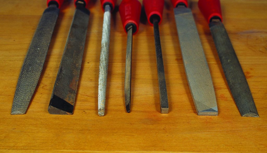

Files
A file has three main parts: the length, which is the cutting surface covered with teeth; the tang, which is where the handle is attached (never use the tang as a handle); and the heel, which is the transition between the length and the tang. Files come in wide variety of types and profiles.

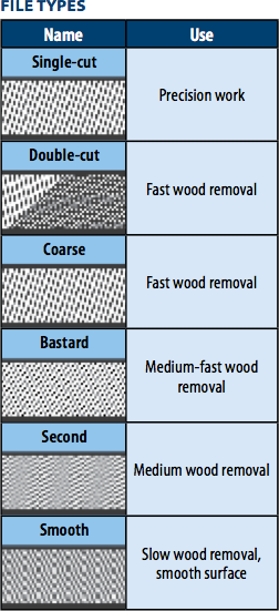

Types of files: You need to understand both the cut of the teeth, that look like lines, and how coarse or smooth a finish they make. From coarse to smooth, the distance between the teeth diminishes. However, a smaller file has teeth closer together, even if it is labeled coarse. In general, the longer the file, the coarser it is. To help the consumer, manufacturers often stamp the cut between the first row of teeth and the tang.

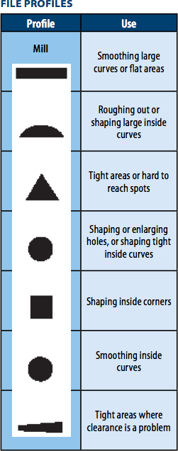

File Profiles: Once you’ve determined what type of file is best suited for the job, you can further refine the usefulness of the tool by selecting the correct profile or shape.

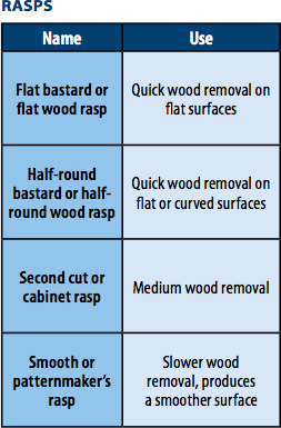

Rasps

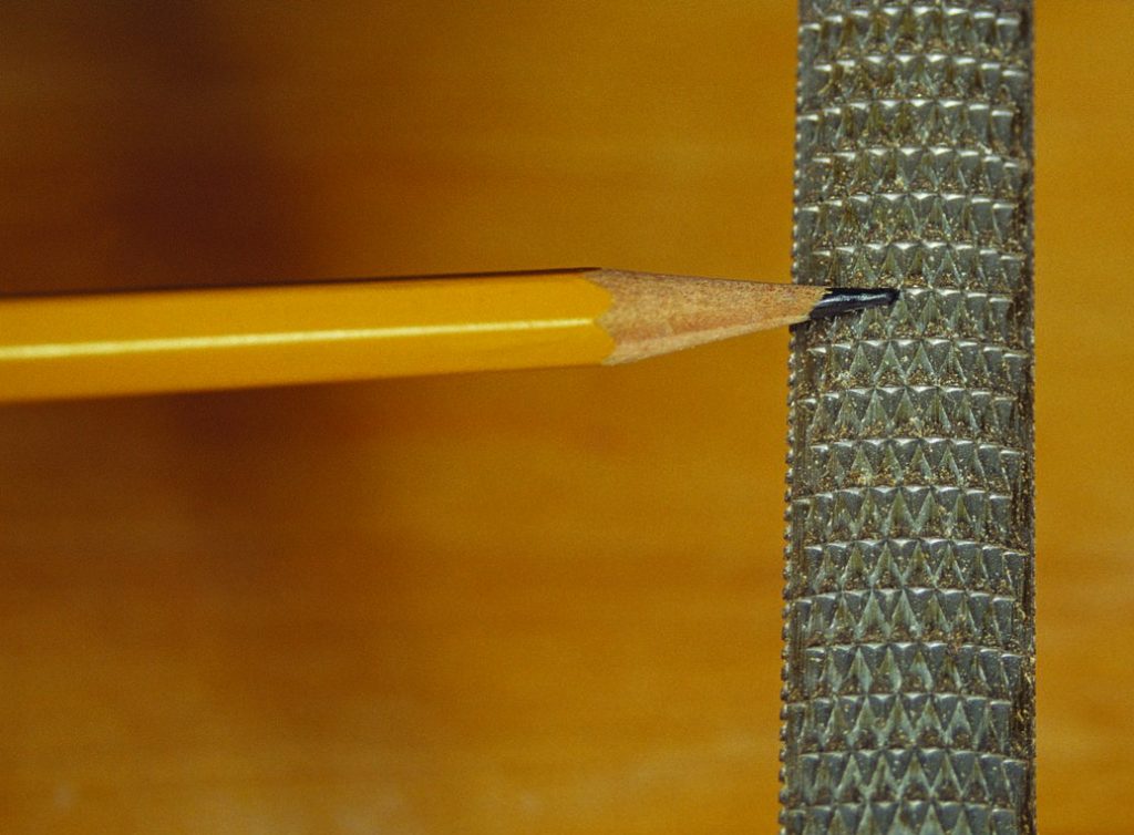

Rasps make deeper and coarser cuts than files because they have separate and triangular, rather than parallel, lines of teeth. Rasps scrape away wood rather than plane it away as files do. The rasp is well suited for shaping wood quickly. Files have gullets or spaces between the teeth that fill with wood chips. One advantage a rasp has over a file is that the teeth resist clogging, but rasps are only available in a limited variety. The size and distribution of teeth determine a rasp’s degree of coarseness and the amount of wood it can remove. All cut rapidly but will leave a rough surface.

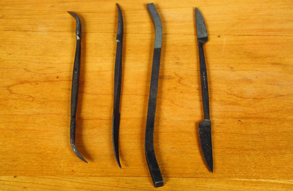

Riffler comes from a French word meaning to file or scrape. A riffler is a small, double-ended file, rasp, or both, with a gripping area between the cutting edges. It is fashioned to work in tight spaces. Common end shapes include straight, curved, and knife-like. Rifflers come in a variety of profiles, such as oval, triangular, square, round, and half-round.

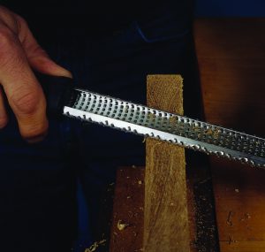

Microplane’s stainless steel blades, which come in round, triangular, and flat shapes, offer razor-sharp edges. I tried my flat-blade Microplane on a piece of white oak and was more than pleased with the results. The wood disappeared without a great deal of effort. For the power carver, there are 1″ and 2″-diameter rotary cutters with 1/4″ shanks. These tools should be used on a drill press running at a maximum of 1200 rpm, not in a hand drill or flexible shaft tool.

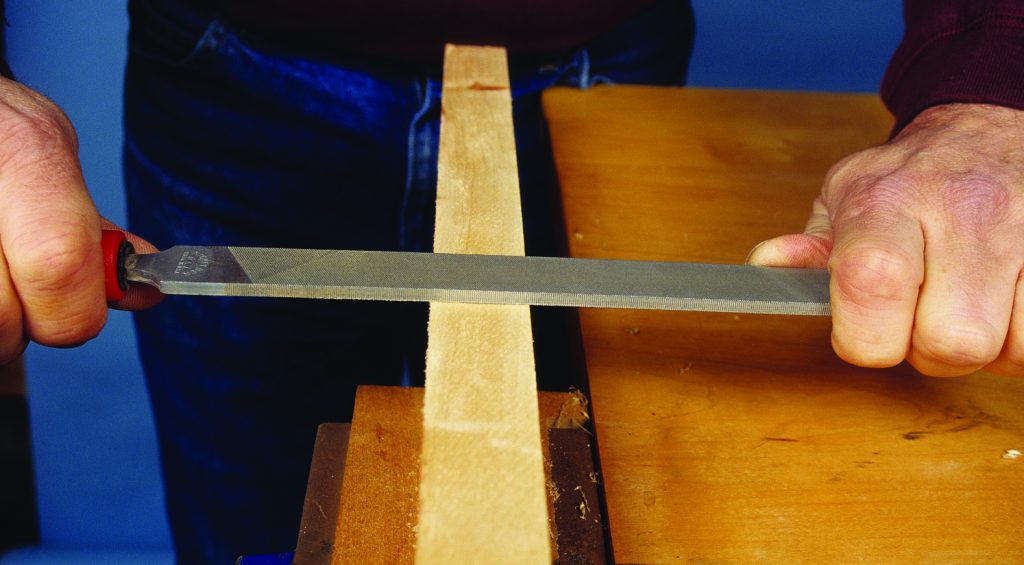

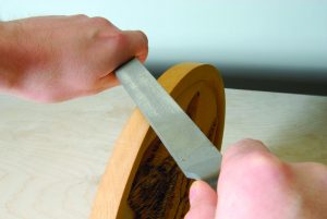

Draw filing, a finishing stroke, requires you to hold the file in both hands at right angles to the wood and push across it with light pressure. Since the teeth of files cut only on the push stroke, lift the tool up on the return stroke. A beginner’s problem is overdoing the push stroke operation, resulting in an unwanted hollow.
Cross filing is done at an angle, not straight across as the name might suggest. Hold the file with both hands and apply enough pressure so the teeth do not catch on the wood grain and cause the file to skip over hard and soft grain changes. Working at an angle is critical when using rasps. Filing parallel or perpendicular to the grain will tear and break the wood, leaving the surface ragged, with a lot of follow-up work required. Cross filing will prevent that from happening.

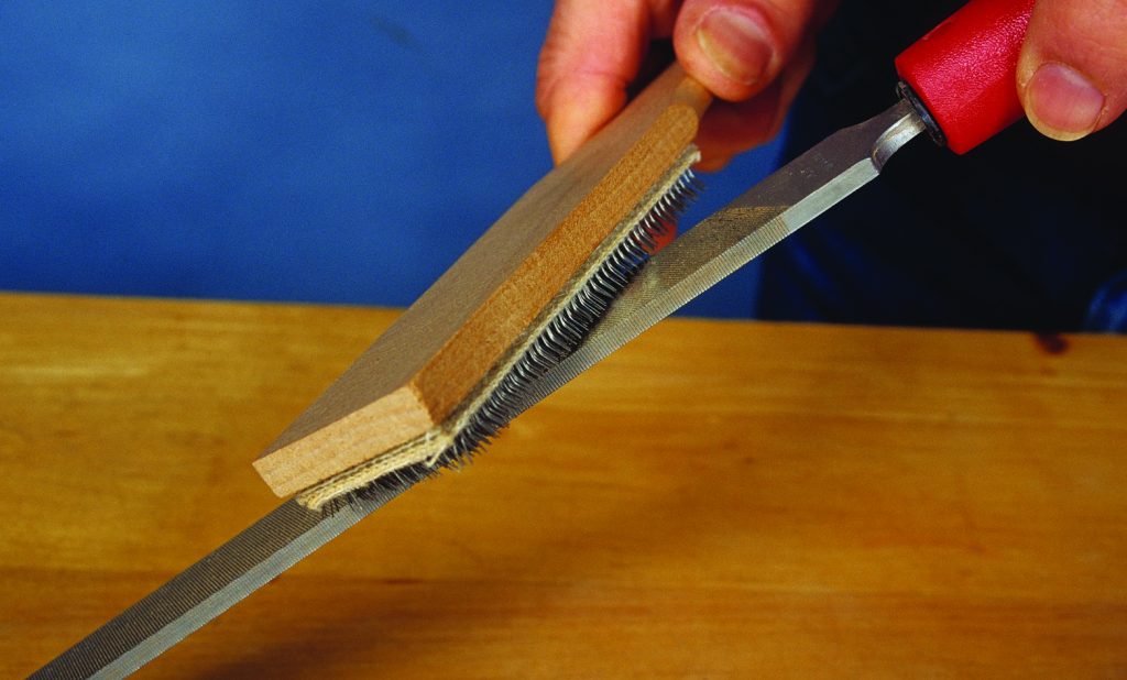

A file card is the best investment you can make for unclogging a file that has filled with wood chips. Purchase one that has nylon bristles on one side and short, stiff steel teeth on the other. Badly clogged files require you to brush the file with the steel teeth. Stroke the brush parallel to the file’s teeth. If you want to prevent heavy clogging, use the bristle brush frequently. If you chalk the teeth heavily prior to use, it will discourage clogging. Do not oil a file; it will make it difficult to dislodge dust and wood chips.
